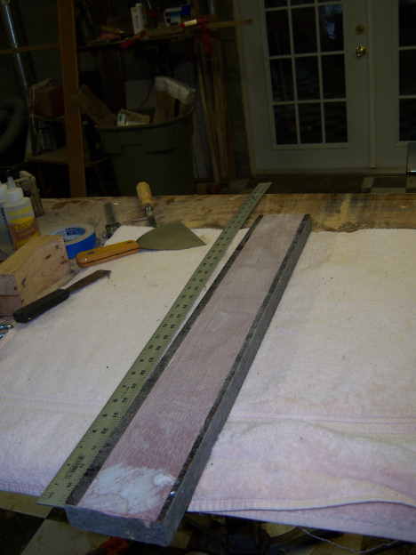

Nothing could be cheaper than a piece of scrap marble kitchen counter top and a piece of self adhesive sand paper. I use that for all of my tops.

Hodges Guitars wrote: Nothing could be cheaper than a piece of scrap marble kitchen counter top and a piece of self adhesive sand paper. I use that for all of my tops.
What kind and grit of sandpaper would you recommend?
.[/QUOTE]
I use 220 sandpaper.. I can surface both sides to perfection before you can find your plane...

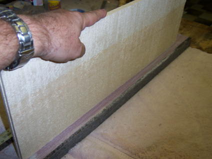

Peter,
it is just a piece of cut-off kitchen counter marble top with self adhesive sand paper attached to it.... It is dead flat and a few strokes with the top or back on edge will plane them to perfection.
Just remember to change the sand paper between light and dark woods as the dark woods will leave a dark stripe on the light top woods when you put it together.

It does't seem it can get any easier than that.But isn't it important to have your wood 90 degrees to the paper? seems to me if its not you won't be maximizing your glue surface area.
Peter
PostPosted: Fri Jul 27, 2007 2:12 am
peter, think about the geomtry. if the wood is not at 90^ the glue joint area actually becomes larger, not smaller. i have read of some who advocate the joint not being a true 90^, but i can't recall who it was.
that being said, having the joint at 90^ makes alignment much easier, and i don't think the amount of extra glue joint area gained by having the joint off 90^ is of any significance. it is a simple matter to build a fence to keep the joint at 90^ if you want to try the method.
i am not in favour of it, particualrly in view of all the research which shows that a planed glue joint is superior to a sanded one.
